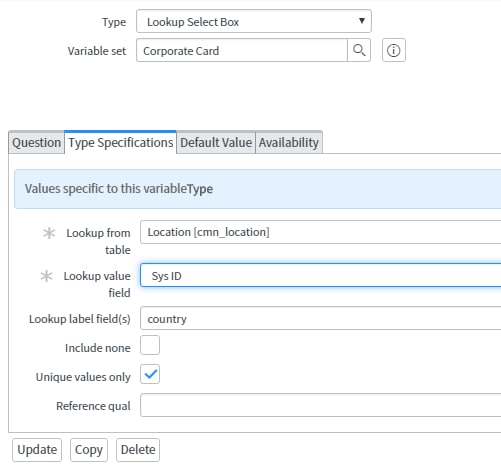

Set default value
Tried to look up by sys_id and name both
This is what i get when it's a look up
The country's are still a choice
When i make it a single line text field instead of a lookup select box, it's blank.find_real_file.png

Hmm...I configured that in an instance both ways and it works, even though for the lookup select I think the value and label should be the country field. I would check your browser console for any errors when you load the catalog item.
