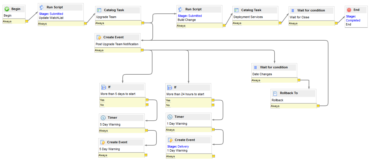

We are just starting to use the SLA plugin rather than the legacy way of handling SLAs. Yes, 3 years late...
I wanted our techs to see the escalation field change colors just as they are used to, but the SLA plugin stops using escalations.
So, in the SLA Workflow, I created a Run Script after each SLA Percentage Timer with the following script. Screenshots attached. Yes, this works for INC and I'm still working to get it to work for other task types. In the script, 1=moderate, 2=High, and 3=Overdue so just change them for each percentage stage.
var inc = new GlideRecord('incident');
if (inc.get(current.task)) {
inc.escalation = "1";
inc.update();
