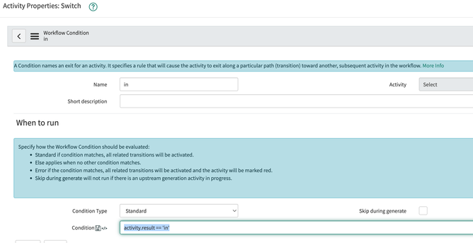

I am trying to create a switch case condition on workflow for a variable with type as lookup select box.
But it's not getting the correct value from that lookup table.

So a Lookup Select Box type variable is not supported with this activity, and as you discovered, does not detect the values.  You could try to manually add a Condition for each value - just use the syntax:
activity.result == 'value'
in the Condition field
