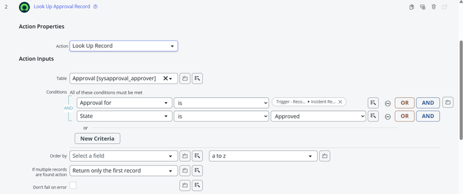

2) Then use 'Look up Record' Action and lookup Approval task that created previously.

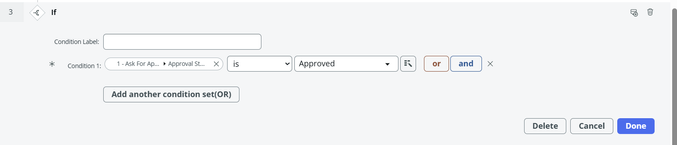

3) Then add if conditon just like below

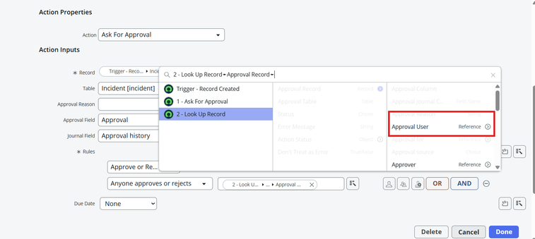

4) And add 'Ask for Approval' action to send approval to person select in Approval User(In your case the field name is different).
