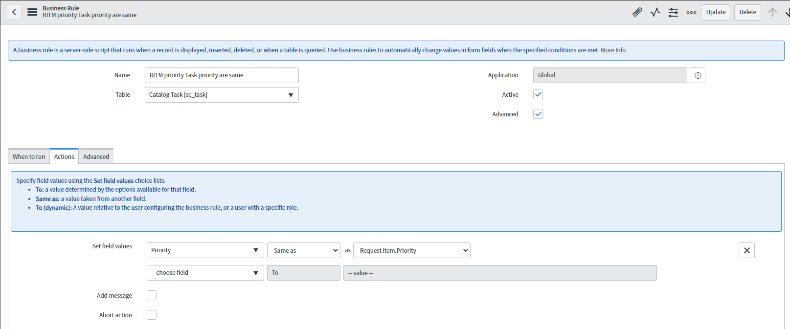

Currently the RITM and Task priority is set to None. However, when a manager decides to select either a priority of 1,2,3 0r 4 on the RITM, the same priority has to be reflected on the Task.
We have multiple catalog items therefore changing the workflow would be tedious.
I have tried using the business rule too but it does not seem to work.
Any help will be appreciated.

Hi
I have over 100 catalog items. How can I modify the script without loading the sc tasks?
Mallika
01-14-2022 09:38 AM
If you do not put any filter on the BR for item, it will run for all items.
How do you identify whether the priority copy should run for a catalog item? What is your selection criteria for over 100 catalog items?
01-14-2022 09:58 AM
Is there any other way this can be done? Because updating the workflows would be a long process. Unfortunately according to the requirement, there is no selection criteria. The process owner wants the task priority to be populated if the RITM is changed.
