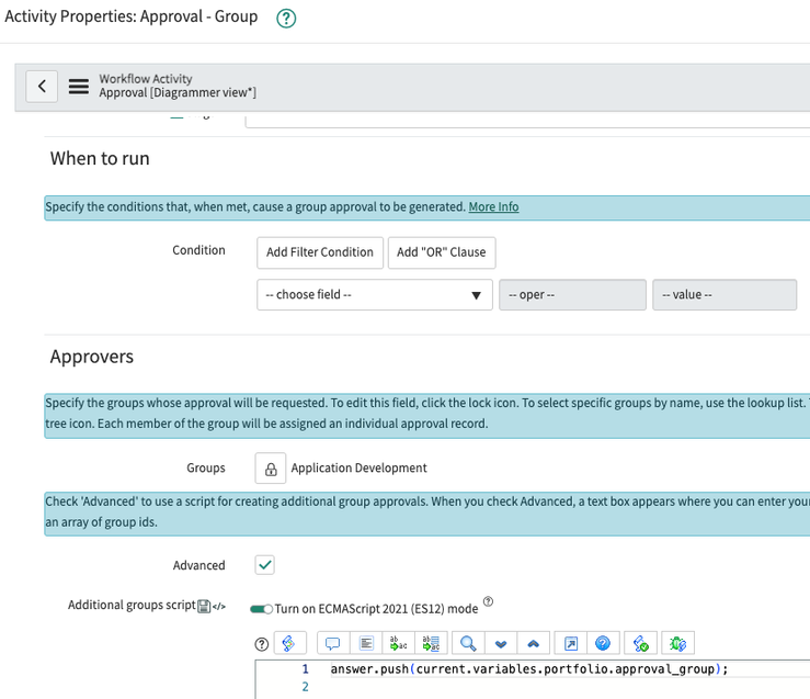

I have a custom table called portfolio which contains a field approval group which refers to group table. Also i have a catalog item which has a variable (reference type) which refers to Portfolio table. So i want when i select any Portfolio record in the catalog variable approval should go to the particular group which is present in that record. There is a existing approval group activity in workflow through which multiple approvals are getting triggered . So from there i need to trigger the approval to the groups.

The Approval - Group workflow activity has a script where you are or can push a group sys_id to the 'answer' array.  If you already have a script, you can just add another line like
answer.push(current.variables.portfolio.approval_group);
where 'portfolio' is the variable name and 'approval_group' is the name of the field on your portfolio table which is a reference to the sys_user_group table.
If you don't yet have a script and the existing approvals are via the Groups list field, you can try checking the Advanced box to add a script for this approval.  If you're not getting both/all groups, you may need to also push the sys_ids of the groups listed in the Groups list field to the script.
Yes I have an array so I added this line and tested but failed to get result.
