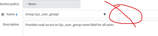

I have added an ACL for the sys_user_group to have read access to the table. I have a catalog item with a reference to this table to allow users to select the required support and approval group for a business application. I cannot get this to field to populate any options for a user with no roles. ITIL and Admin can see them just fine. I have added the below script to the advance section as well as I have previously done for another table.

Can you try with just
answer = true;
You are only giving read access to Name field. You can add conditions later.
‎01-10-2022 12:43 PM
So you have this on the sys_user_group.* level...that's not correct.
You'd do it on the sys_user_group level without the *
And for your script, I've covered that above as to why that wouldn't work and gave alternate script.

Hi
Please review my last reply...the "read" ACL needs to be on the table level...not a table.field level. Remove the field selection "Name" and set it to none, as I had mentioned in my last reply.
Please let me know if you're confused?
