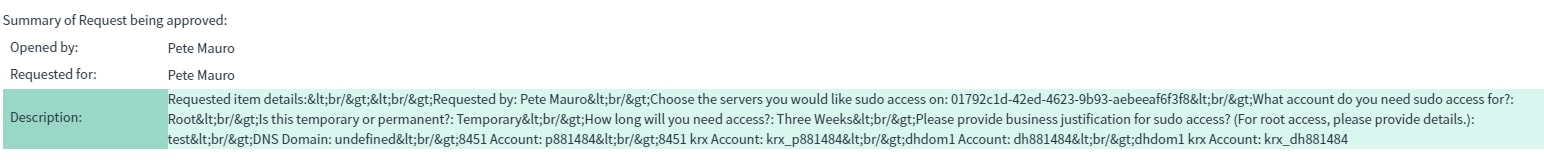

A piece of XML in a UI Macro that hasn't changed since 2014 is now causing HTML tags to display on the user end.  The UI macro involves some old Jelly functionality and specifically a glide.ui.escape_text.  Attached is the UI Macro causing the issue and the HTML tags in the request item.  Please let me know if more information is needed to get to the bottom of this.

Hey Dan,
Thanks for your help, Replacing all "INSERTNEWLINE" text replacements with "&lt;br/>" seemed to work in some places but in approvals with more references to our UI Macros it just replaced the tags we were seeing before with the new text replacement.  If there are any other potential workarounds you know of or if I implemented this the wrong way please let me know.  Attached are screenshots of another request with the XML code and how I implemented it in our UI macros.
