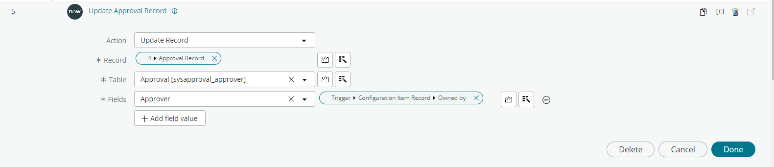

5. Update the approval record with the new owner. If you want the notification for approval to go back out you may need to double check the conditions on the notification to make sure it triggers on update.
I was not able to test this because my change does not work this way so make sure you test it in a sub-prod environment. Also you should comment the flow.
