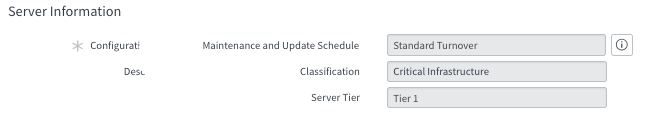

I have a workflow I've build against my change_request table that I need to use a dot-walked field as a switch in the workflow. The dot-walked field doesn't exist on the cmdb_ci table but on the cmdb_ci_server table so I created an additional reference field cmdb_ci == u_ref_cmdbci_server that is hidden on my change request form. The field that I need in the switch is u_vmfolder. On my change request form I am able to see these fields find when I insert the expanded references using Configure > Form Layout.
Here are the fields in the change request:
Here is the switch in the workflow:
and the switch conditions:
