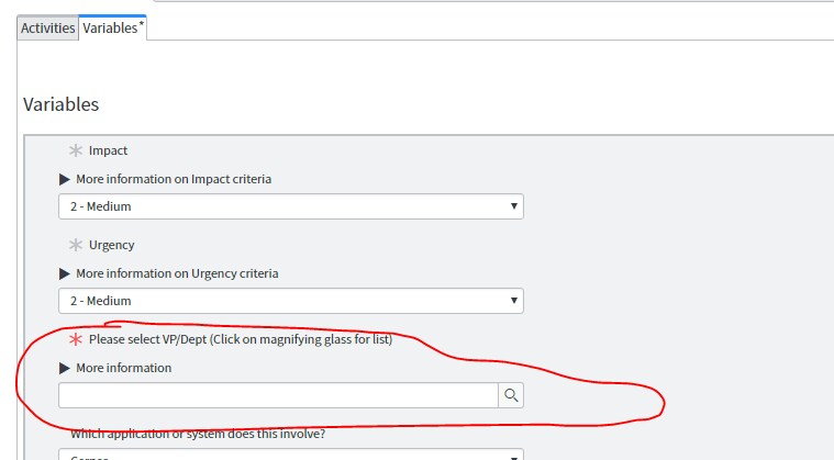

We just upgraded our DEV instance to London Patch 1.  First thing I noticed is when a request comes in one of the variables is not transferring over to the RITM.  It is a required field when you complete the request.  Why would it not transfer over?

Need some more information here.  Where is the variable defined?  When you say 'transfer over', where do you expect to see it?  Some screenshots would be helpful.
On the RITM form we have the variables tab and this is where the variable should be showing.
So the variable is showing but the value is empty?  Is that the problem?
