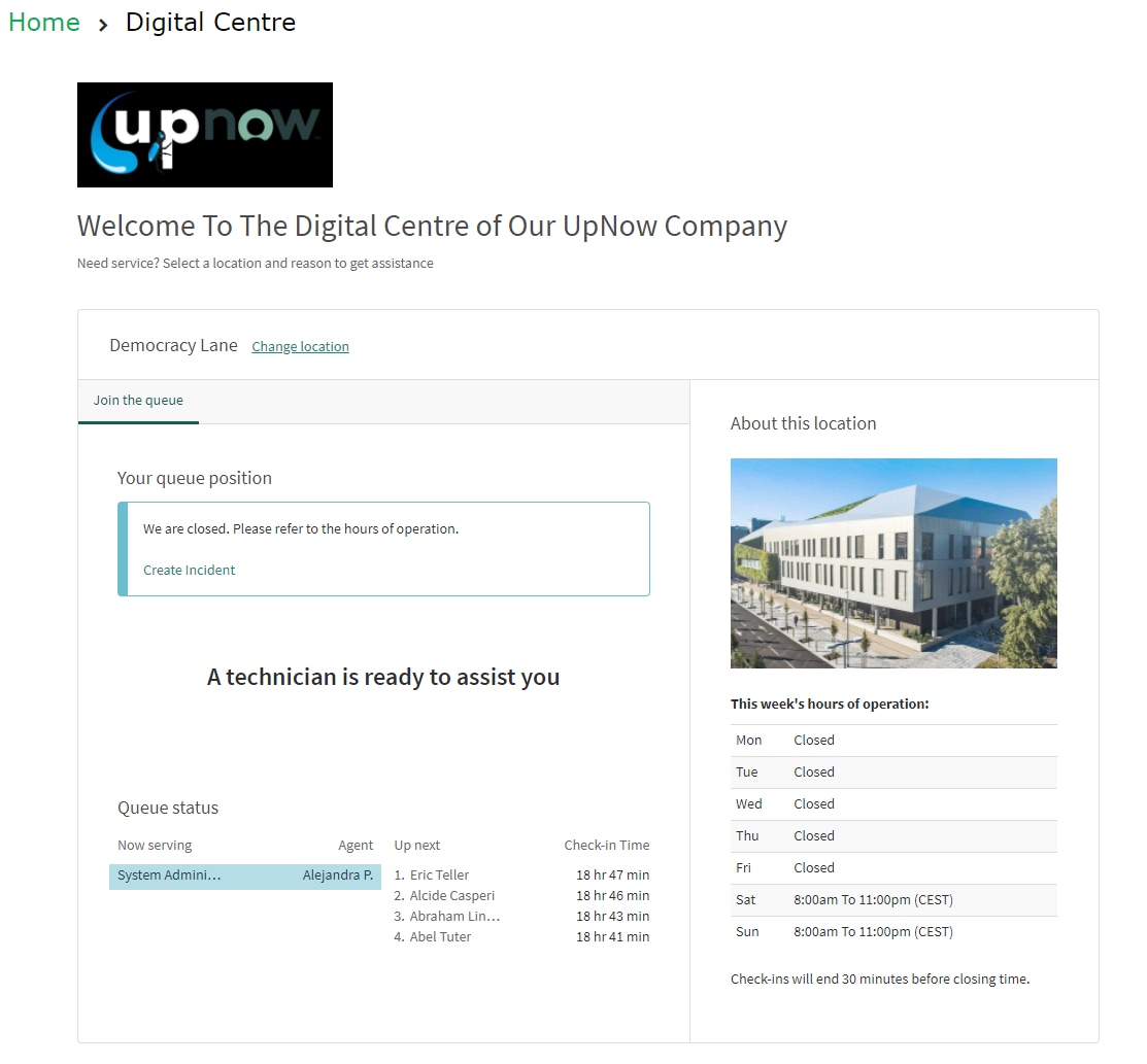

But when I add the Walk-Up Experience check-in widget to my Service Portal, there is not a "Schedule an appointment" tab :

But I have still the same widget without the tab "Schedule An Appointment" on my portal.
Have I forgotten to add a widget or something like that or is it a problem with Appointment Booking Configuration ?

You have to create record in this table - sn_apptmnt_booking_service_config
After that you need to associate it from walk-up location record.
Have you done that?
Thank you for your advice, the tab is effectively appeared and works now.
