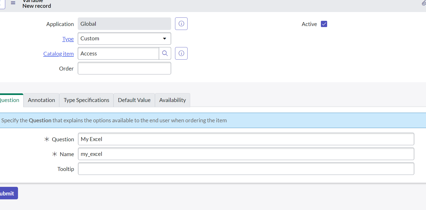

Hello
For this you need to create a widget and tag it to a "Custom" type variable like below

Then you need to tag this widget in the custom variable that you have created
Output:
