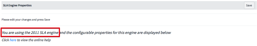

You can see which version of SLA engine you are running by going to the SLA engine properties module which will have a sentence at the top of the page indicating which version you are running:
There was an additional property introduced with the 2011 engine which provided support for the "legacy" stage values of "Achieved" and "Breached" for users switching from 2010 to 2011.   This property can be found on the same SLA engine properties page:
The upgrade to Helsinki shouldn't have changed any of these properties but it's worth going to the "sys_properties" table and finding the property with name "com.snc.sla.compatibility.breach" and checking to see if it's been updated recently - if it's false then you will not see "Achieved" or "Breached" in the Stage field of an SLA.
