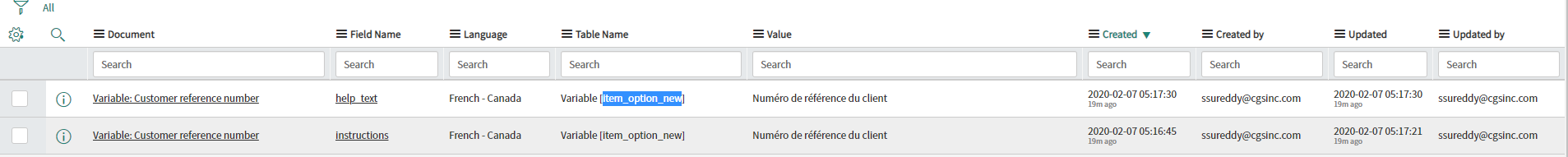

Right now i used item_option_new filed name as instruction and help text.

If it's about the Variable Question: have a look at table "sys_translated".

Also did you tried what I already mentioned? A sys_translated record would also be generated if you would setup the Variable first in English, switch your language, and then update the Question on the Variable.
