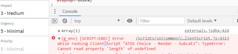

When I inspect the page, it gives below error:
The client script is same as displayed in the previous post.
Any help appreciated.
Did you check you are getting value for this
renderFields
Try to add alert and check
Possibly it is empty or undefined and you are trying to use length on that in the for
