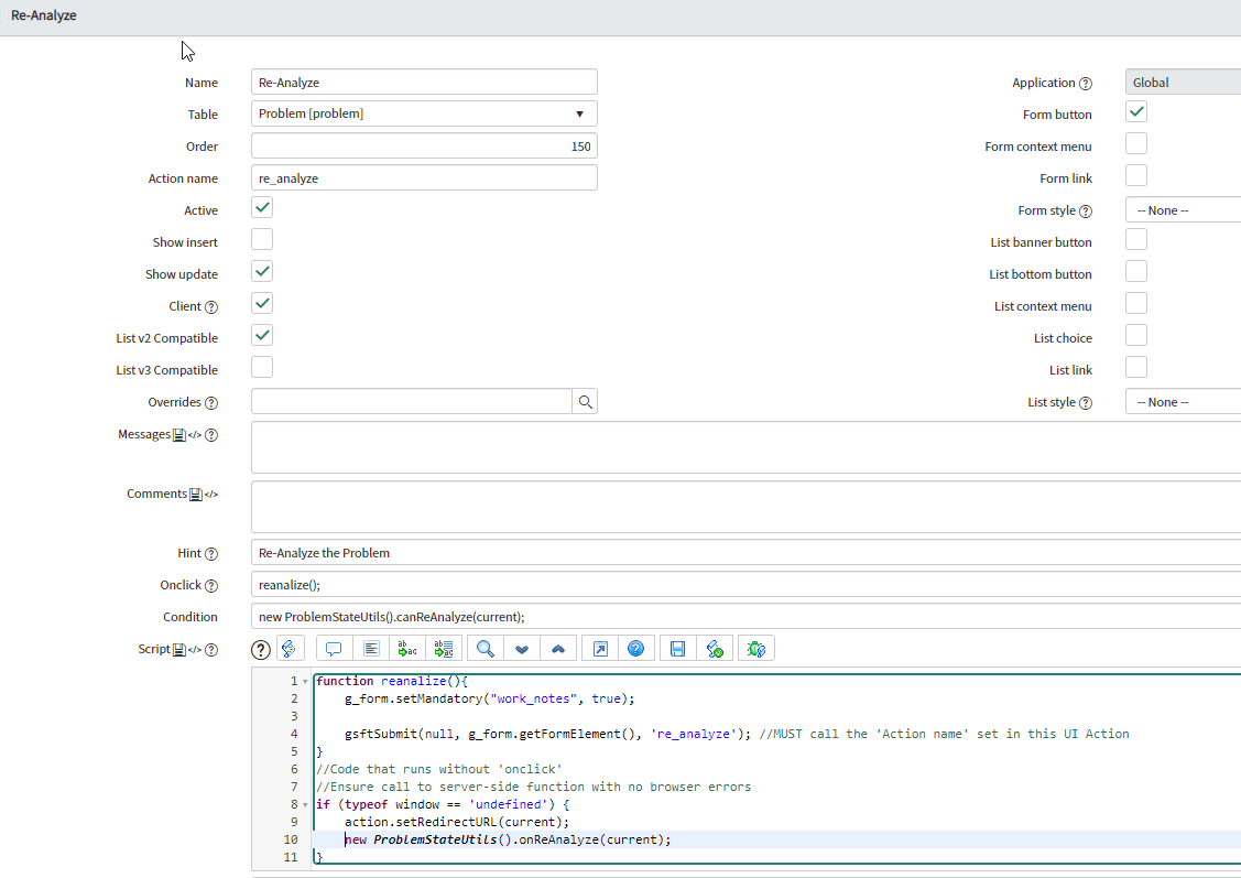

Filipe Cruz
Hello pooja,
You need to do a couple of changes in the UI Action:
- mark the checkbox "client"
- on the onclick, insert "reanalize();"
- replace the script by this one:
function reanalize(){
	g_form.setMandatory("work_notes", true);
	if(g_form.getValue("work_notes") != "")
		gsftSubmit(null, g_form.getFormElement(), 're_analyze'); //MUST call the 'Action name' set in this UI Action
//Code that runs without 'onclick'
//Ensure call to server-side function with no browser errors
if (typeof window == 'undefined') {
    new ProblemStateUtils().onReAnalyze(current);
Then your UI Action should be similar to this:
Just for you to understand:
- when the ui action is pressed, the onclick will execute the code that is there, in this case it will execute the function "reanalize".
- The function sets the work_notes as mandatory and if the work notes are populated it will trigger the code that will run outside of the onclick function. That is the code that was there before!
Let me know if this works for you!
Please, don't forget to mark my answer as correct if it solves your issue or mark it as helpful if it is relevant for you!
Best Regards,
Filipe Cruz

Hi Pooja,
Try this make sure you check 'Client' as checked and add 'reanalyze()' in Onclick field. Mark my answer as correct if that helps.
