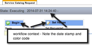

08-01-2014 06:46 AM
Abhiram has the right idea:Workflows are actually broken into
- "Version" (think template or definition file)
- "Context" (think copy associated with ticket / record / etc)
When the conditions for the Version are met, SN copies a record into the Context table, associating that context with the ticket / record / etc. If you are looking at a workflow - you can easily tell the difference between Context and Version:
Version will have the title in the center and no color coding of Activities:
Context will have the timestamp to the left and color coding:
If you modify the Version and want existing contexts to be changed, again, Abhiram is right in the main: you would need to dis-associate the existing contexts - deleting or removing them in some way - and then finding a way to get those records to pick up the new Version and make copies in the context table with the new version.
