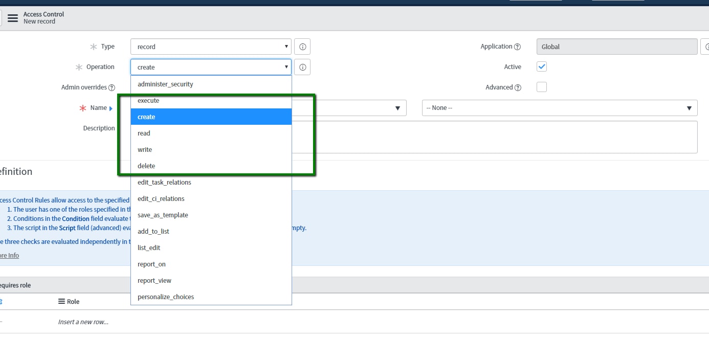

cmdb_ci_service table has 3 read ACLs, some users from CMDB does have write access to these table and other doesn't have write access. I am trying to find what ACls could have been given to CMDB group to have write access to the Business Service table. When I look in the ACL table I can only find 3 read ACLs on cmdb_ci_service table. Can someone help me understand how this group was granted Write acess to this table.
05-12-2019 04:04 PM
Yes, this is because there was already a write ACL on one of the parent tables. As soon as you create a write ACL on this table, it overrides the ACL on the parent table.
So the key is to do the steps I gave you above to find the exact ACL that is currently being applied for write access, then if you decide you want to create a new ACL for your table, you also need to make a copy of that other ACL (along with its roles) that is currently controlling access, and set it to apply to your table.

Raj, thanks for the reply. I am trying to find out where this specific group is getting write access from. When I checked the write access for the table, there is nothing related to write access ACLs.

Thanks for the reply Rahul. I created a write ACL on the Business Service table but it taken off write access to other people that already have write access on this table. New ACL only granting access to particular role that was given to the new write ACL.
