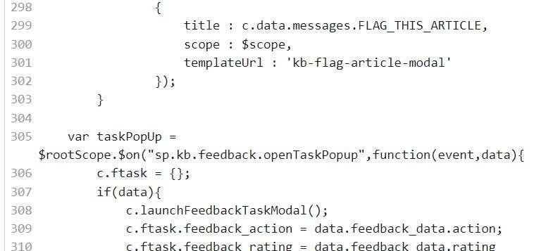

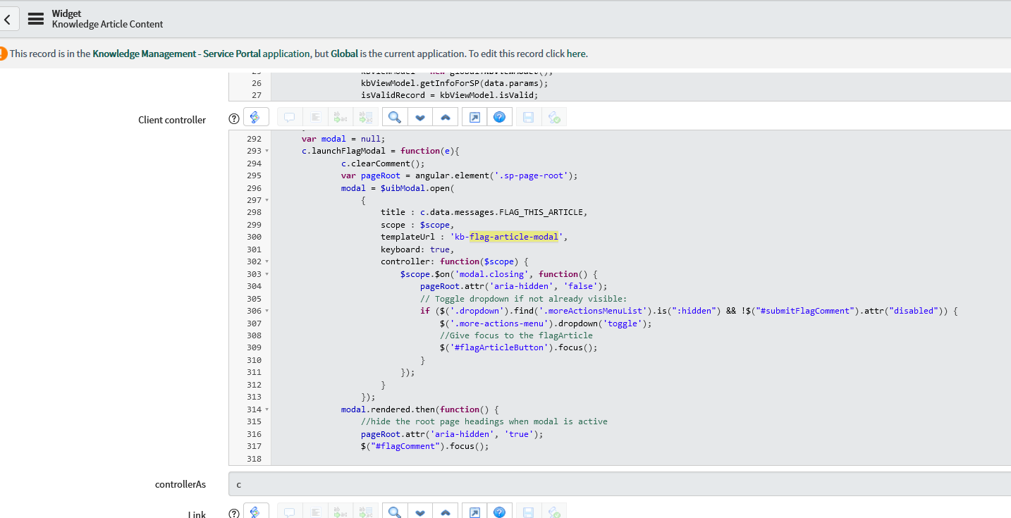

Hmm I don't think either of those errors are related to your pop-up not displaying.
I think it is some issue with the angular ng-template that is meant to display that flag pop-up, is the 'Knowledge Article Content' service portal widget or the 'kb-flag-article-modal' ng-template customized at all?
