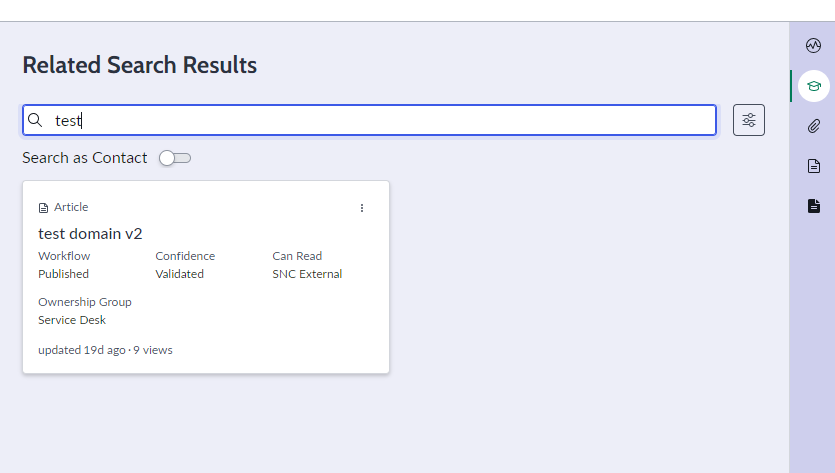

If you go to Contextual Search > Search Result Display Configuration, you can configure the cards that show in the agent workspace to show additional fields such as workflow_state, confidence, can_read_user_criteria, cannot_read_user_criteria, ownership_group
You can also enable the search as contact/search as caller toggle via Contextual Search > Table Configuration which will allow agents to quickly toggle the search to only see results that the end user would be able to see.
Example of both below in the agent assist panel within agent workspace
