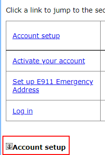

I do these jumps in the html code. This is an example of a jump ref for "Account setup":
<a title="Account setup" href="#setup">Account setup</a>
Then, in the body of the article where you want to jump to, you use this code:
<a name="setup"></a>Account setup
I picked the word "setup" as the jump reference so when it finds that word it jumps there.
This is what the link display box looks like:
And this is what it looks like when you've set up the jump ref correctly:
