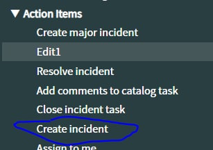

Open the ITSM agnet app in studio,
The find the Action Item -> Create Incident and open it
Once Opened scroll to the bottom you will find all the Parameters(fields) configured
Just delete the fields which you don't want

01-21-2022 09:32 AM

01-21-2022 09:41 AM
Awesome. Thank you!
