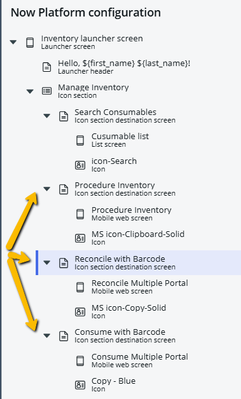

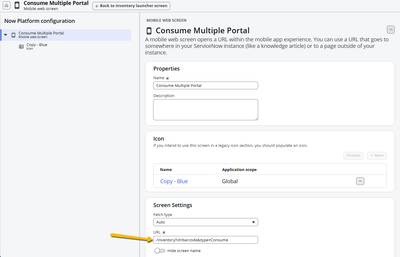

I've been able to complete my code and have a function mobile app that does multiple barcode scanning and keeps track of the list of scanned items.  I've made it work for a barcode scanner as well as for the using the Cabrillo framework.  I'm using the native Cabrillo in the Now Mobile custom application that uses a Page/Widget on our Inventory portal.  Here are a couple screenshots of the configuration:
As you can see, we have multiple icons that point to Mobile Web Screens component.  Here is how our Consume Inventory configuration that points to the inventory portal using the barcode page with a type of consume.  We use the same page to do consuming as well as reconciling inventory.
