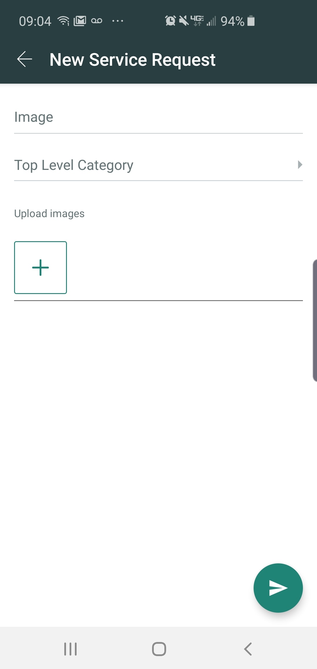

Hello everyone,
I am working on an app in Mobile Agent.
I have an Action Function called New Service Request, that allows the users to create new records. The function is set to "Allow Images Upload". It works in a sense that the '+' sign does appear on the form and after choosing or taking a photo, the photo pops up on the right side of the '+' sign.
However, when I tap submit, and then view the records list using Mobile Agent, the record is there, but the image is not. I also check the sys_attachment table, and the image I uploaded does not appear in there either.
How does attachment upload work, and how does it get stored in the app?
Any help would be appreciated!
