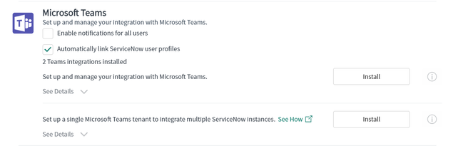

Initially, we configured the integration on our dev instance. As shown below, we have the following two integrations installed:
The integration between dev and MS Teams works great.

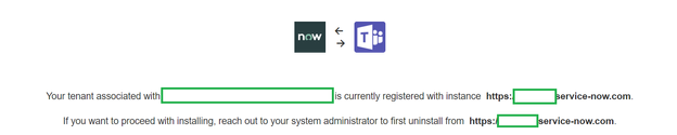

Now, we try to configure the integration on our test env. After clicking on the Install button, next to "Set up and manage your integration with Microsoft Teams." message, we see that our tenant is associated with the dev env and we can not proceed to configure the integration on our test env (see img below).
Should we uninstall the integration from our dev environment and then install it in test environment? But if we do so, we will not be able later to monitor and test the integration on our dev environment.

Yes, you should uninstall the tenant in dev and proceed with test for now, and similarly do it in prod.
One tenant can be connected to one instance only. Say for example, if the tenant is installed in prod only, then end user requesting live agent, the system will notify the agent in prod, if we can install tenant in multiple instances, then the system will notify in which one? dev or test or prod? Definitely multiple confusions out there.
So you can install one tenant in one instance only.
