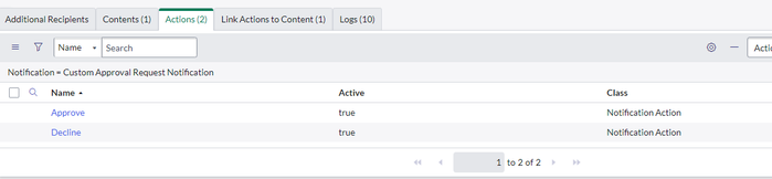

Here are the actions under the "Actions" tab:
My actions are script actions, and they look like this (this is for the Approve script action, the Decline looks similar, see code comments):
(function action(
		/*GlideRecord of sys_notification_execution*/ execution,
		/*GlideRecord of sys_notification_action*/ action,
		/*GlideRecord of sys_notification*/ notification,
		/*GlideRecord of record changed to cause notification*/ target) {
	target.state = 'approved'; // Rejected action has this as 'rejected' instead
	target.update();
	return 'Approved'; // Rejected action has this as 'Declined' instead
})(execution, action, notification, target);

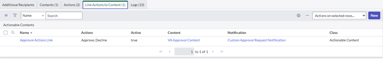

And here is the Link actions to content record that seems to be stopping the notification from sending (record is defined in the Global scope):

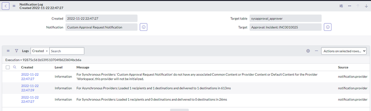

Here is an example of the notification log for a notification that does not get sent:
At the top of the notification provider, I also see these two info messages. I'm not sure if it's relevant to my issue as the notification was still able to be sent when the actions weren't linked:
