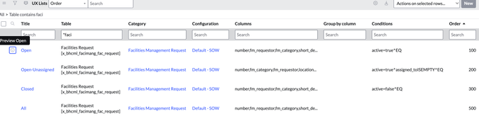

Step 1: Initially, establish or define modules within this table – sys_ux_list
Step 2: Utilize this table to categorize the list - sys_ux_list_category

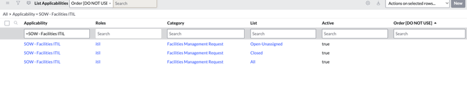

Step 3: Configure right audience(roles) using Audience form - sys_ux_applicability
Use the Roles list collector to add roles for which this list menu should be visible.
Step 4: Map the audience to the lists - sys_ux_applicability_m2m_list
This is how the end result looks like :
