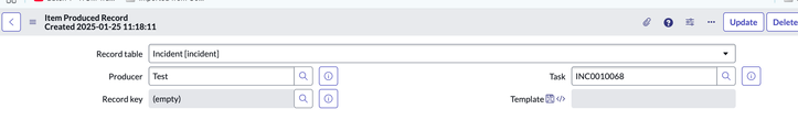

There is a table 'sc_item_produced_record'. From the application navigator, type sc_item_produced_record.LIST
You can check all the records created using record producer.
Ex: Producer: Test (Record Producer Name)
       Task: Record created.
Now, write a Business rule on sc_item_produced_record table with the following condition,
Producer | is | <Your record producer which creates major incident>
in the script,
Create an Outage and associate it with Incident whose reference you can get from this record populated in the Task field.  (current.task.sys_id)

Hello i need to access to certain information, and i cannot access from that table
Hello @abigailtaba
TASK field refers to the Incident object, and from that you can all the information of the incident.
task.sys_id - SysId of the Incident
task.short_description - Short description of the Incident.
Can you tell me is any other information that you are looking for ?
If the above information helps you, Kindly mark it as helpful and Accept the solution,
Najmuddin.
