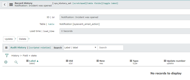

‎11-01-2022 08:43 PM
Hi @Rain Vaine ,
I do not see any reason why notification will not be triggered provided it is active as well as satisfying the condition as well. Could you please share the screen shot of When to send section of the notification.
Also, check the history of the notification and check what is the change history for active tab. Did it change recently

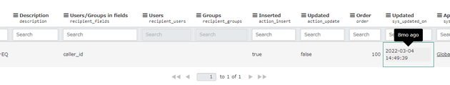

‎11-01-2022 11:23 PM
Yes this was how the when to send tab appear for this record. As you could see it has the same configuration as the oob. And no record history is captured in the record. Is it possible to change the record during the tokyo updgrade? For example turning it to true without the sys_updated_on changing?
when I checked the updated_on time it could be seen that this record is last updated 8 months
but during those months this notifications is not sending
