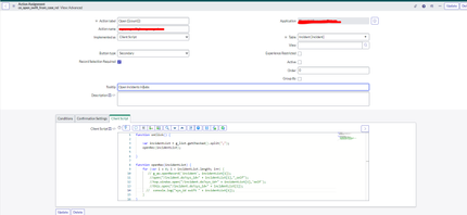

For 1, I created a related list action (Now Experience Framework -> Declarative Actions -> Related List actions :
Here I tried the supposed to be most simple solution by creating a FOR loop and using
g_aw.openRecord
This works, but only for 1 record, it never works within a for loop and I tried in multiple SN versions.
On top of this I've tried other different ways, using open(), top.window.open, this.open, all of these open the url but on new browser tabs, not within the workspace.
So , does anyone have idea how to get this one working ? Is it even possible as a client / server script? I'm thinking on going the UXF Client Action way, but for that my option 2 must work.
