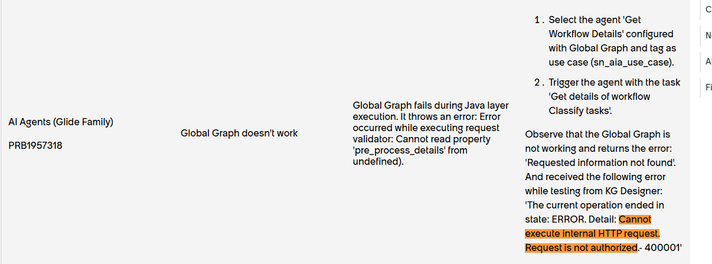

Hello @JK9903 ,
This is a documented ServiceNow bug (PRB1957318) in the AI Agents Java tool-execution layer, specifically around Global Graph/KG calls, fixed in Zurich Patch 4 and Yokohama Patch 11. Compare your dev and test patch levels a patch gap is the most likely reason it works in one and not the other.
Refer here :
Zurich Patch 4
Hi @yashkamde , Both instance patch are same
