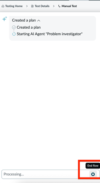

If you're in a live running execution in AI Agent Studio Testing playground, you can use the "End flow" button here:

Thanks @warren_chan , this looks like what I want to do, but I am not clear how to navigate to the point shown in your screen shot. I am in the AI Agent Studio per my earlier screen shot, and per the screen shot below. I started an agent manually by entering a prompt into the Test AI reasoning input area under the Testing tab. I then tried to click on various items in the Testing tab, including on the Manage evaluation runs button (which opens a new tab that shows no active runs); and on various steps in the AI agent decision logs area; and in the center AI process map area; but haven't found the menu items in shown in your screen shot.

My screenshot is from Now Assist AI Agents 6.0.17 (Zurich Patch 4 + December 2025 release), so it looks slightly different from yours. I can't recall when exactly we introduced the "End flow" button, but updating your app version will likely open that up. This was a big customer ask to have a way to terminate execution in AI Agent Studio.
‎01-05-2026 12:11 PM
@warren_chan I upgraded to Zurich Patch 4 and to Now Assist AI Agents (sn_aia) 6.0.17, then to 6.0.23, and still no End flow button (see below for a screen print from Agent Studio; on the Activity tab the flow still shows In progress). My other plugins look to be up to date as well. Anything else you can think of as to why I can't see that button?
