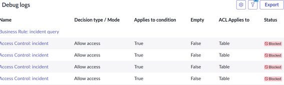

Found a solution for our scenario, it might not work for yours but could help to find what is happening, basically it was a Permission issue OOTB AI user relies on OOTB ACLs that were removed by customer.
The root cause:
Customer had several new ACLS and also disabled the OOTB Incident* ACL (this want grants write access to all users with Itil role to table incident) this affected the write privileges of the AI user that comes out of the box such as itsm.aia.worker
Here's what the Access analyzer showed us about Write access for ITSM Worker ai Agent [itsm.aia.worker] all blocked, no write access because of several ACLS customizations. bottom line this user might work if an instance is very vanilla.

Tuesday - last edited Wednesday
The root cause:
