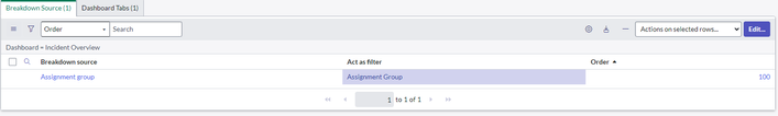

You can create a breakdown and make it act as an interactive filter. By doing this, then you can make it aligned across the tabs (off course the interactive filter needs to be the same for this to work).

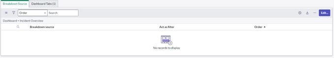

1. Go to dashboard properties:
2. press "edit" on breakdown source
3. add a breakdown source from the slush bucket and press "save"
4. select the interactive filter it should filter (the one aligned across tabs) in "act as interactive filter":
Press update
You now have a breakdown source acting as interactive filter across tabs in dashboard:
