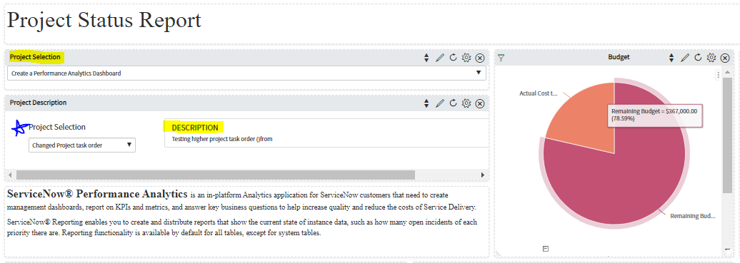

This code spits out the "Project Description" block below (picture provided includes dummy data). Rather than using the filter I had created here (blue star), I would like the project description to populate based on selection from the filter above it.
Were you able to accomplish this or something similar?
Any advice would be immensely appreciated!
