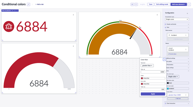

The easiest and arguably easiest to read solution would be to use single score data visualisation with icon, and set conditional colors based on values, instead of coloring the background. You can control separately color of icon and color of score itself (best practice is to set color for icon and keep score itself neutral/black, but you can color both if you want).
Similarly you can use dial or gauge visualisations with similar color controls (benefit of the gauge is that user can actually see the ranges and understand logic of when things are red/amber/green)
This option is available on in-line dashboards in Platform Analytics.
