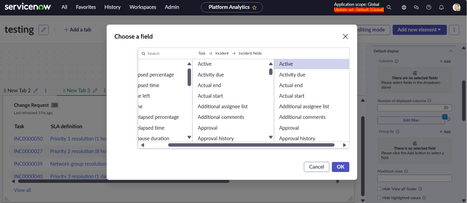

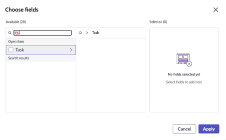

I would really appreciate your help with this. In my PDI instance, Platform Analytics allows me to see all child tables under the Task table and dot-walk to them while adding columns in a report. However, in my dev instance, none of the child tables under Task are visible when trying to add columns in a Platform Analytics report. What could be causing this issue, and how can I make the child tables visible in my dev instance?
In My PDI:
In MY Dev Instance:

Hi @ThorS ,
Thanks for the reply. I have the admin role in my DEV instance and tried both Global and Scoped apps same result. It works fine in my PDI, though.
In Platform Analytics, I’m trying to access Task SLA > Task > Incident > State as a column, but it’s not showing. Dot-walking works in the filter section, just not while adding columns. Both instances are on Yokohama, and the system properties "glide.ui.list.allow_extended_fields" is true in both.

Hi @AndersBGS,
Thanks for the response. The base table I’m using in Platform Analytics is Task SLA, and I want to display columns from related tables like Incident and Problem to show the incident number, state, and SLA breach time together.
I tried using Task SLA > Task > Incident > Number to display it as a column. I have admin access, so it should ideally work. Could you please guide me if there’s any way to make it work?
