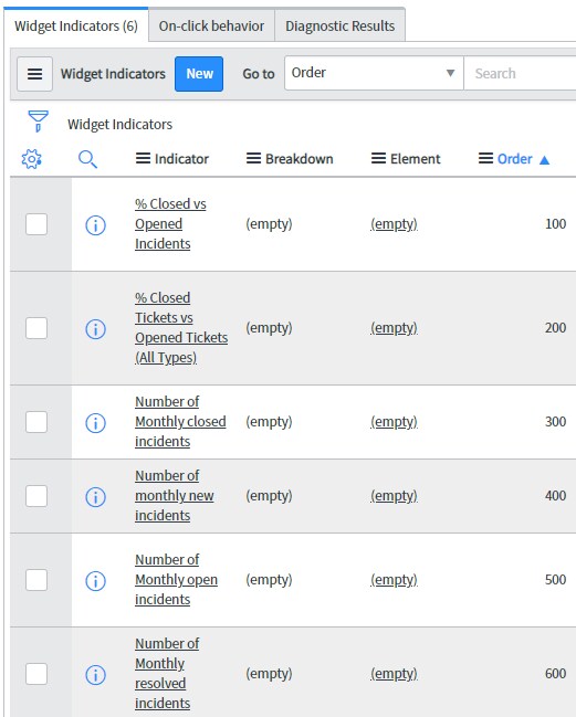

I have created a list widget that is made up of 6 indicators and have the settings as followed:
In the widget indicator settings, I have set the ordering to be as followed:
When I view the dashboard, the indicators are not being displayed in the custom sort ordering I have set. Has anyone experienced this same issue or found any workarounds. I know labeling each of the indicators as 1) Indicator 1, 2) Indicator 2, etc.. will work but would like for the sort ordering to work properly.

I was able to resolve this issue. I had to set the ordering in the indicator properties instead of the widget properties and the custom ordering worked successfully.
