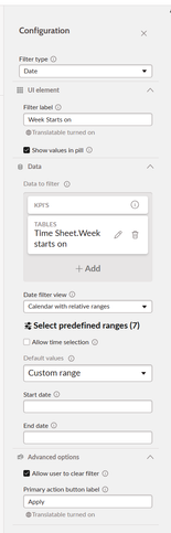

I am building a simple list visualization (The requirement is to show users who are missing a time sheet for any given week) on a Platform Analytics Dashboard. This list is built off of the User table (sys_user) with 2 conditions (Active is true and Roles is timecard_user), and 1 Related list condition -> Equal to 0 selected table record(s) are related to a record on Time Sheet-->User.
I have 2 filters that work. One filters by User and the other by the User's Manager. Both of these are built using the User table (sys_user).

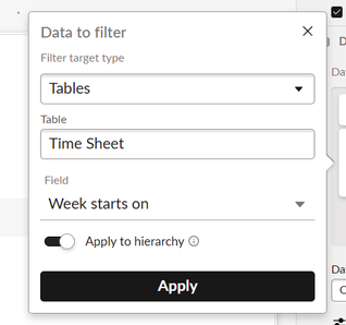

This issue I am having is building a Date filter for "Week Starts on" which is on the time_sheet table. I am not finding a way to link it back to the user table. I have tried setting the "Apply to hierarchy" to true and false to no avail.
Is this even possible? If so, any insight or suggestions would be greatly appreciated.

Hi @Rampriya-S Thank you for the reply. I used the out of box indicator to build a list report using the same exact conditions and Related Table conditions (except for the week starts on). What I am looking to do is create a dashboard filter to allow the user to select a different range of dates to see those records.
So, in other words, the report will not contain a filter for the Week starts on. Meaning it will only show users who never created a time sheet - in our environment we have 2 users (we went live back in June with timecards). What the ask is to have a Week starts on date filter so the leader can select a date or range and then see users who are missing time sheets for that week or range of weeks. Does this help provide clarity on my need?
