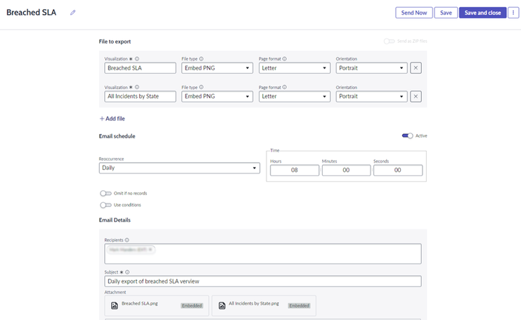

First: you can only schedule the data visualizations that are in the Platform Analytics library. From there you can start the schedule.
(If you haven’t done anything with Platform Analytics yet, data visualizations are the new name for ‘reports’).
As you can see, I selected the file type as ‘Embedded PNG’. This means that the report will be in the email as picture, instead of attachment, which makes it way more useful, especially if you are sharing more visualizations.

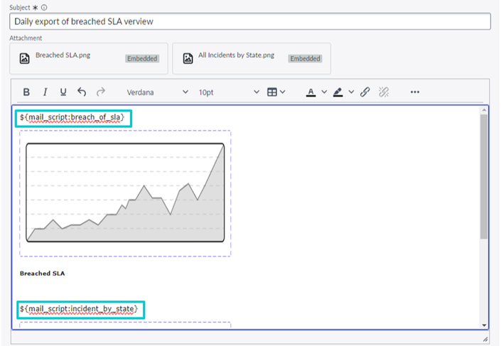

I did some testing after my question on the academy wasn’t answered. You can use email notification scripts in the scheduled emails. And this opens up lots of possibilities.
Let’s say that you are sharing a semi donut of task_sla records grouped by ‘has breached’ to show the result of last week.
If you want to tell a story, you want to say something like ‘Look at our awesome team. Not a single SLA was breached last week’ or ‘We noticed that the breached SLA’s are concerning at the moment and we are looking into this’.
By using email notification scripts you can query to the task_sla table and check if there are any breached SLAs. If not, you can simply return your ‘we are awesome’ text into the scheduled email.
By defining your thresholds and making your notification script(s) check on these, you can create a huge number of different text fragments you are showing in your email.
