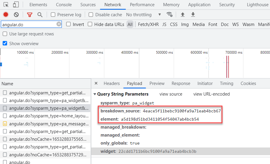

If you look at the call made when you select a breakdown in a dashboard, you can see there will be an "angular.do" call where the following two parameters are passed:
If you have a look at the "Performance Analytics" widget, you will see that you could just pass those parameters into the "angular.do" call yourself (e.g. read it from the URL and then set it in the "params" object). However, you have to be aware that the "httpOptions" below actually only seem to be used if it is a react widget (see "isReactWidget" function to check which widgets are react widgets).
