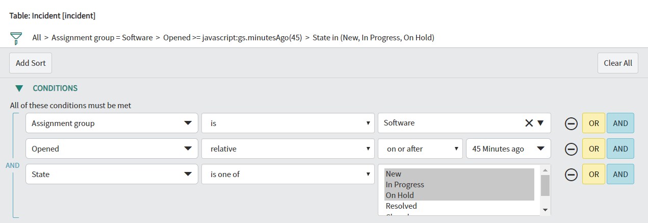

For date filters in the query the easiest way is to set the same filters on list view and then copy the query in the script in the addEncodedQuery().
This works very smoothly and doing it yourself in the code is way more complex because of different timezone ServiceNow uses (like the system store the time in GMT, users timezone could be anything and also systems timezone could be different).

  1. Create a report with filters looking something like this-
