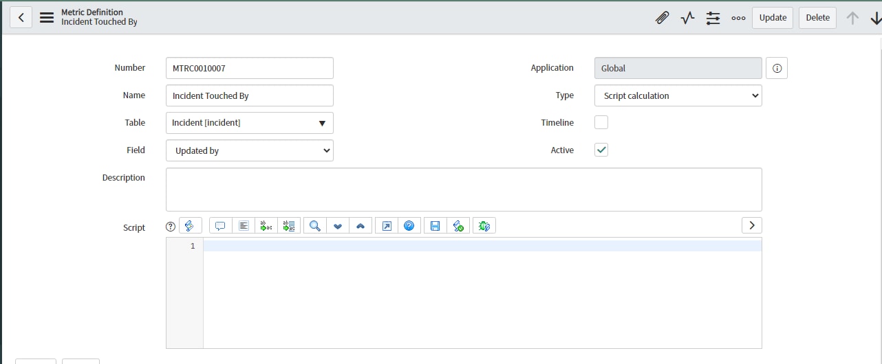

That's a bit trickier, but it can be done.
We first need to create a metric definition. Set the type to script calculation and the table to incident. Leave the script field blank, we will be using a business rule to create the instances.
Now we need to create a metric instance each time a user does something to the incident. We can accomplish this with a business rule.
Create a new business rule that runs on inserts and updates to the incident table. The rule will create an incident metric each time the incident is updated by a user. This counts all changes to the incident as a "touch", including things like adding worknotes, changing the state or assignment group.
Check the "advanced" checkbox and go the the advanced tab. Then paste in the following script. Make sure to replace the sys_id to the one of the metric definition you just created:
