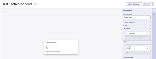

For reference, I have a single score report:

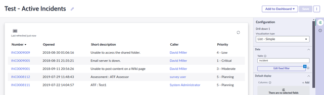

My drilldown is a list view of those records:
And this is what it looks like on the dashboard:

For anyone else looking for the answer to this, as of the versions I've mentioned in the original post and according to support, the link to get back to the report isn't available in a list view drilldown yet. It sounds like that functionality is coming in a future release.
