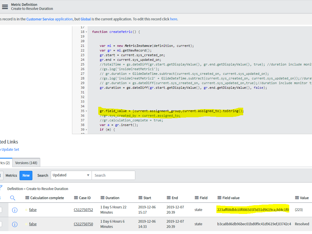

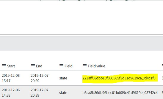

I'm having an indicator on the metric_instance table. this metric holds in the 'field value' field two sys_id's separated by comma (string field).
And I have an indicator that has two breakdowns one is on the users the other is on the groups.

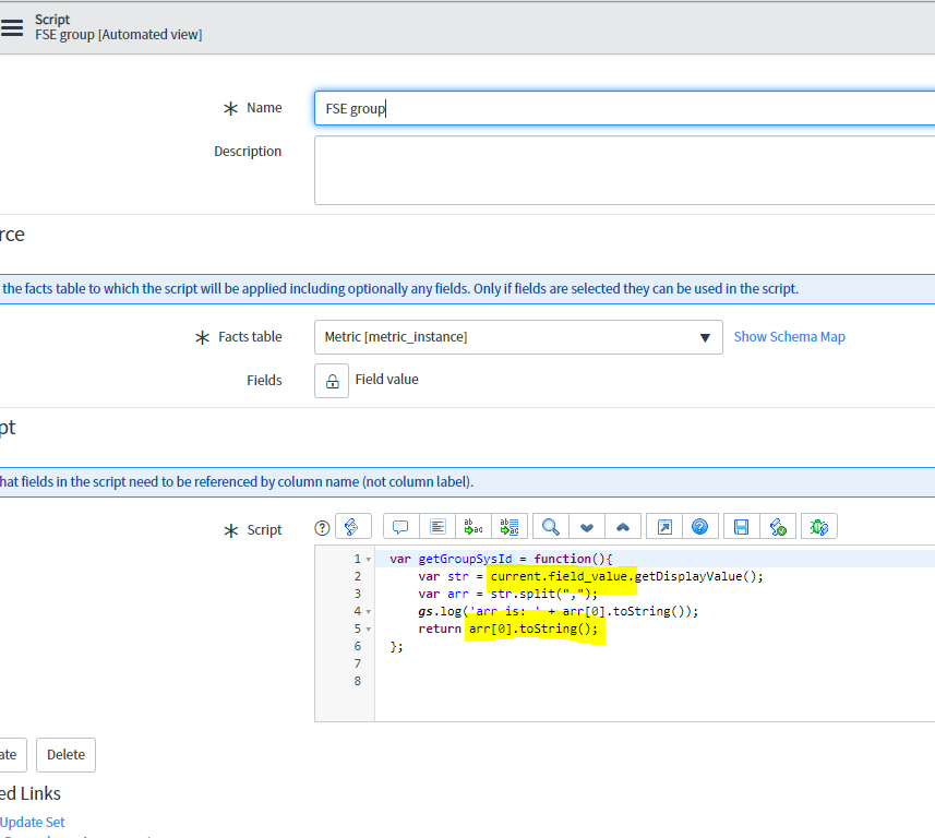

Each one of the breakdowns has his own scripted breakdown mapping.
When I executing a job on this indicator I'm having this error :
Error during JavaScript evaluation com.snc.pa.dc.ScriptException: JavaScript evaluation returned: Undefined in script: var getEngineerSysId = function(){
var str = current.field_value.getDisplayValue();
var arr = str.split(",");
return arr[1].toString();

Could you please give a try with below code
getEngineerSysId: function(){
var str = current.field_value;

Hi Alok,
I tried this before and I get the same error :

My requirement is to measure the the time from incident creation to resolving, without monitor time - if exist - thats why im using a metric.
I should have 2 breakdowns - groups and users.
The metric table has only one field from type string that can holds sysId - thats why im putting over there the two sysIds.
