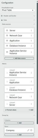

@Lisboa  can you try using multiple data sources within same pivot table visualisation if that helps.

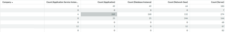

That did the trick!  Thanks for the assist on this one!
Output references for anyone who comes looking in the future for how it was accomplished.
--Kevin
Hi @Lisboa I am glad that it helped you! Great!
Appreciate your efforts in putting snapshot of outcome for others to refer if needed.
