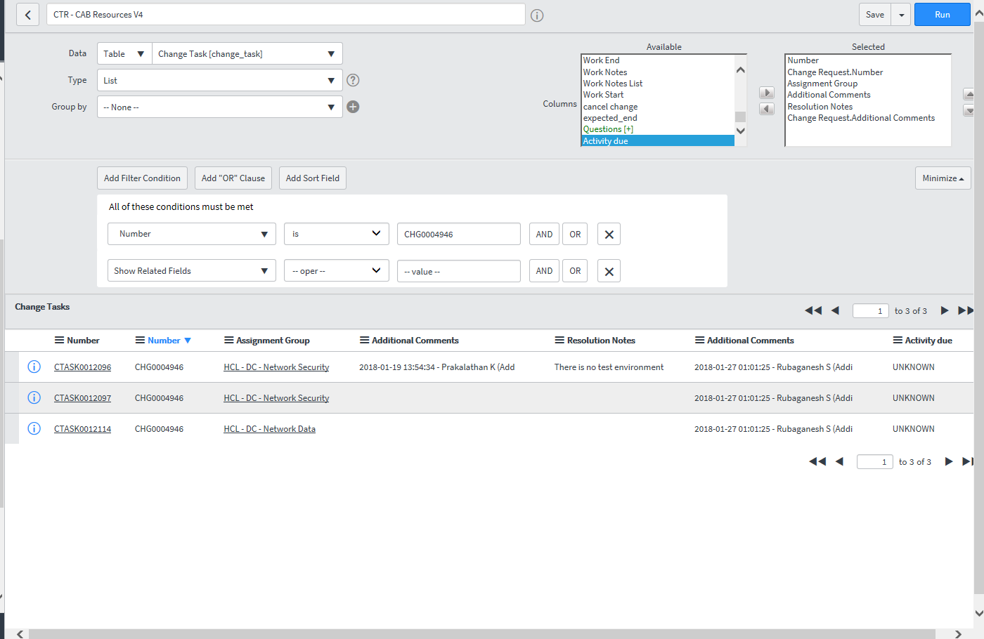

I created a report using Change Task [change_task] table and can view the Work Notes (number 3 below screenshot) and Additional Comments(number 2 below screenshot)on the Notes Tab. I can't figure out field in number 1 below. Number 3 has yellow bar on left side of box. Number two has black bar on left side of box. Number one is grey. If I hover on right side where date and time stamp for box is it will tell me Additional Comment (2) or work notes (3). I don't get anything if I hover over date and time on number 1 below. I believe system creates this note when the change is made. I am trying to create a report for when the planned start and end date gets modified (Number 1 below shows example of this). I would like to create report to capture that information. I am currently on "Helsinki" version of ServiceNow. How can I get this information on report?
