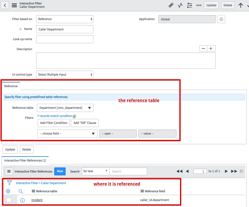

Reference interactive filter
the interactive filter on incident reports for the user's department should not be a problem. The user's department is a reference field on the sys_user table. When you define a 'reference' interactive filter, you can also define (after initial save) how it should be referenced from which table. (You can make references from more than 1 table.)
