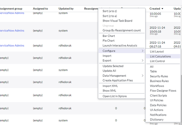

I'm working on sc_req_item to get total request / average duration / max duration / min duration per item.
Currently the aggregation can only select one at a time for a report, is there a way to display all these (total request / average duration / max duration / min duration) in one report?
Uncle Rob
From a standard list view you can modify the list calculations to add any aggregate you want to the base of the list.
